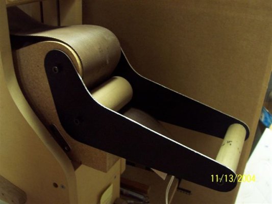

PostPosted: Sat Jan 08, 2005 2:43 pm
Posts: 1534
First name: Nelson
Last Name: Palen
Thought this approach to bending cutaways might be of interest. The pivoting caul with handle gives a good tactile when bending. The side plates are thin aluminum but plywood would probably work fine. The 2" dia. caul is free to rotate. This replaces the cutaway press screw attachment normally seen on a a Fox type bender. It folds up out of the way when loading the bender.
Nelson
PostPosted: Sat Jan 08, 2005 4:10 pm
I like simple. And I like stuff that works. Bruce Dickey
